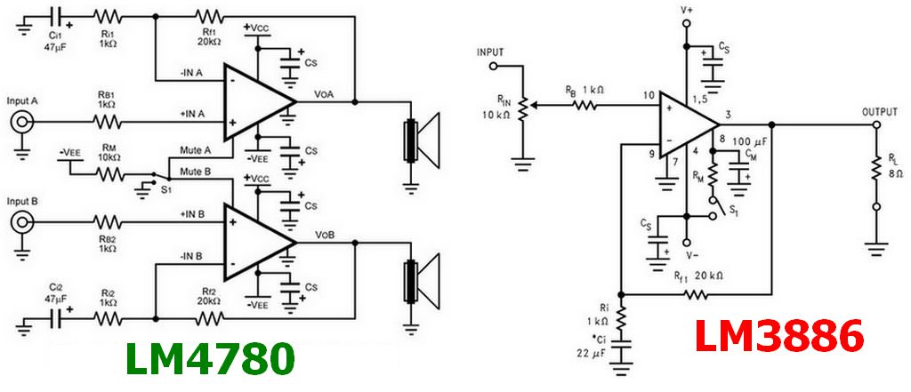

When the datasheet application circuits are examined, it is clearly seen that LM4780 actually contains two LM3886-like amplifier blocks inside the same package. The input structure, feedback connection, mute control, and output topology operate largely with the same logic.
In the application schematics below, the dual-channel structure of LM4780 is shown on the left, and the single-channel LM3886 application is shown on the right.
schematic lm4780 vs lm3886 schematic
In both circuits:
  • Non-inverting input structure is used
  • There is a 20k feedback resistor
  • A 1k input resistor is preferred
  • A mute control pin is available
  • A symmetrical power supply structure is used
Thanks to this similarity, it is practically possible to use two independent LM3886 ICs instead of LM4780.

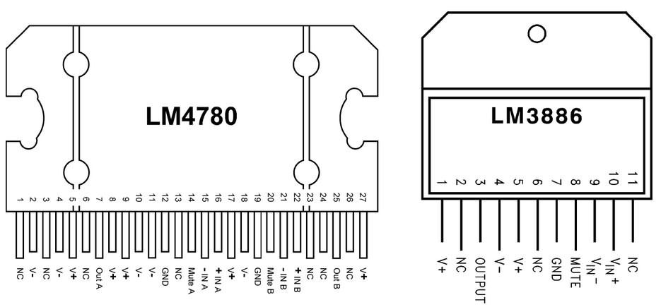

Pin Structure Examination
lm3886 vs lm4780
When the datasheet pinouts are compared, it can be clearly seen that LM4780 combines two independent amplifier blocks in a single package.
LM4780 Equivalent LM3886
+IN A Channel A input +IN
-IN A Channel A feedback -IN
OUT A Channel A output OUTPUT
Mute A Channel A mute MUTE
+V / -V Power supply V+ / V-
+IN B Channel B input +IN
-IN B Channel B feedback -IN
OUT B Channel B output OUTPUT
Mute B Channel B mute MUTE
The point to pay attention to here is that some pins of LM4780 are “NC”, meaning not connected. These pins were specifically left empty in the PCB design.

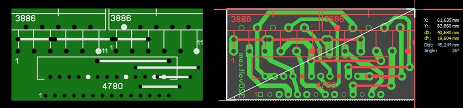

Since there is not much mounting space inside the Genelec 8030A, the PCB was designed as compactly as possible. The dimensions are around 40.5×19.7mm. Two LM3886 ICs were placed in the upper section, and connections compatible with the LM4780 footprint were created on the lower side.

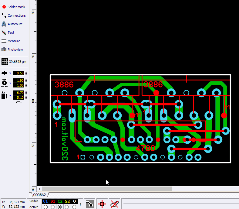

The PCB design was prepared with Sprint Layout 6.
lm4780 to lm3886 adapter pcb
The red lines seen on the PCB represent the upper-layer jumper connections. The green tracks are the lower-layer copper tracks.
The tracks on the lower side will be completely solder-coated. Reinforce the power supply and output sections with extra solder filling, and make the jumper wires 1mm thick.
In addition, I also prepared a double-layer drawing of the same design. The same tracks were added as the upper layer only to make the tracks thicker; these do not have solder mask.
If you will have a double-sided PCB made in China, the upper layer tracks will be covered, but when installing the jumpers, leave them slightly raised so they do not touch the tracks.
sprint layout 6 layer c1 c2 solder mask lm4780 to lm3886 pcb adapter
Special attention was paid to the following details in the design:
  • Output tracks were kept thick
  • Power supply lines were drawn short and wide
  • Mute pins were routed separately
  • Feedback tracks were routed away from the output line
  • Ground returns were kept as short as possible
