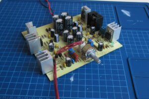

PCB and Modular Structure
The most logical setup for this amplifier is a modular structure. The preamplifier board, power amplifier boards, symmetrical power supply board, 12V power supply board, soft start board, and fan control board can be prepared separately. This makes testing, maintenance, and troubleshooting easier.
Especially on LM3886 boards, the power supply and speaker tracks carrying high current should be kept wide. Input signal tracks should be routed away from the power output and transformer cables. If input GND, power GND, and chassis connections are combined randomly, hum may occur.
  • Power supply tracks on power stage boards should be wide
  • The input signal can be carried with shielded cable
  • Distance should be left between the transformer and the preamplifier
  • Potentiometer cables should be kept short
  • LM3886 heatsink insulation should be checked
  • The mains side of the soft start board should be safely enclosed

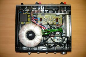

Brief Evaluation
This quadraphonic amplifier prepared with LM1036 and LM3886 is a very educational project in terms of classic analog audio electronics. While volume, bass, treble, balance, and loudness control are performed on the preamplifier side, a powerful output is obtained by using a separate LM3886 for each channel in the power stage.
The project should be considered not only as a power amplifier, but as a complete audio system. Because for a successful result, the preamplifier, power stage, symmetrical power supply, 12V auxiliary supply, fan control, soft start, and mechanical cooling must all be designed correctly together.
With correct PCB layout, solid grounding, sufficient transformer power, good cooling, and careful first startup, this structure can be turned into a powerful four-channel audio amplifier for home use.
4 channel quadraphonic audio amplifier soft start fan control and power supply
lm3886 power stage and lm1036 tone control preamplifier
