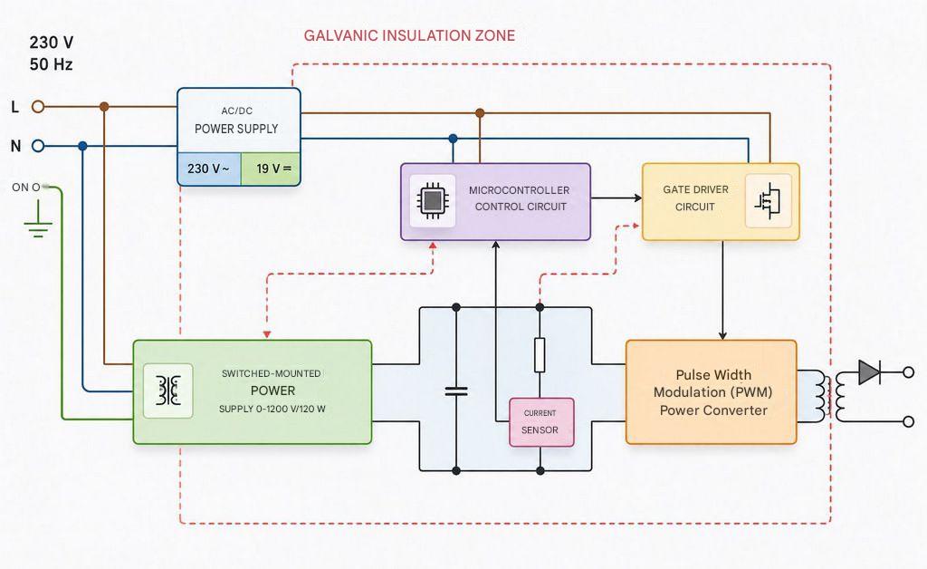

1 1200v main power stage or general block diagram electroporation power supply

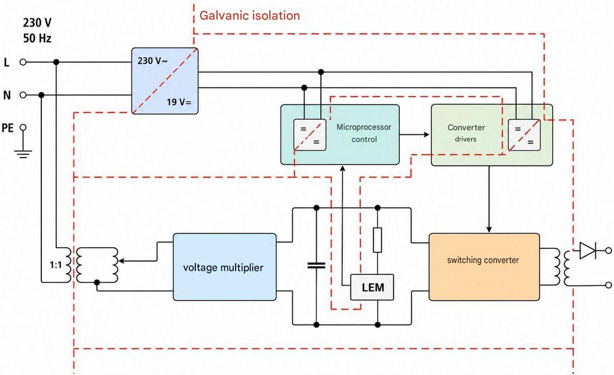

1200v main power stage or general block diagram electroporation power supply 120w
The purpose of this design is to create an isolated high-voltage power supply powered from the 230 V AC mains, with an output adjustable in the range of approximately 0-1200 V and capable of delivering power at the 120 W level.
The circuit is described as a high-voltage source developed to supply the intermediate circuit capacitors of an irreversible electroporation device.
In high-voltage sources, simply increasing the voltage is not sufficient.
The output must be galvanically isolated from the mains, the current must be limited during a short circuit or empty capacitor charging, the switching component must be protected against voltage spikes, and feedback stability must be ensured.
Therefore, the circuit should be handled much more carefully than a simple boost converter.

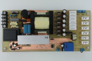

6 transformer winding 1000v electroporation 1200v power supply
In a high-voltage flyback SMPS circuit, the task of the transformer is not only to provide a voltage ratio.
The transformer is also an energy storage component. Primary inductance, air gap, core cross-section, maximum flux density, and winding arrangement directly determine the output power.
An ETD59 class ferrite core is used for the main pulse transformer in the SMPS design.
The primary winding was calculated as 40 turns, and the secondary side was divided into 6 separate sections to increase high-voltage withstand capability and reduce diode voltage stress.
A segmented secondary winding provides a more controlled structure in terms of insulation and rectification compared to a single-piece high-voltage winding.

On the secondary side, the output is not taken through a single diode and a single capacitor. Instead, the secondary winding is divided into 6 sections, and each section is arranged to operate with its own rectifier diode and capacitor. This method reduces the reverse voltage to which the diodes are exposed and makes high-voltage insulation more manageable.
In each section, the capacitor charges to approximately one sixth of the total output voltage. At 1200 V output, this value is approximately around 200 V per section. When the secondary winding voltage and capacitor voltage are considered together, diode selection should still have high-speed operation and sufficient reverse voltage withstand capability.
