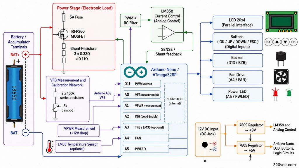

Block Diagram of the Arduino Nano Battery and Accumulator Capacity Tester

General Operating Principle of the Circuit
Arduino Nano battery and accumulator capacity tester circuit schematic
The circuit consists of two main sections: the control section and the load section. The control section includes the Arduino Nano, LCD, buttons, buzzer, fan output, LM35, voltage measurement input, and adjustment components. The load section consists of the PWM filter, LM358 op-amp, IRFP260 MOSFET, shunt resistors, and battery connection.
The Arduino Nano generates a signal from the PWM output. This PWM signal is converted by an RC filter into a voltage close to an analog level.
The op-amp compares this reference voltage with the voltage across the shunt resistors.
The MOSFET gate is driven until the voltage across the shunt resistor reaches the target level. In this way, the circuit tries to draw a constant current from the battery.
This structure is a classic linear electronic load topology. The MOSFET does not operate as a switching element; it operates in the linear region and converts the excess energy into heat.
Therefore, in long-duration and high-current tests, using a large heatsink and a fan for the MOSFET is mandatory.

Arduino Nano and Control Section
The Arduino Nano manages the entire menu structure of the device, LCD text, button readings, ADC measurements, EEPROM records, PWM control, and test durations.
While the original circuit used the ATmega328P directly, this adaptation uses the same processor on the Arduino Nano board.
- The LCD data and control pins are connected to the Arduino Nano digital pins.
- The buttons are connected so that they pull the input to GND.
- The battery voltage is applied to the ADC input through resistors.
- The PWM output goes to the RC filter on the load board.
- The fan and buzzer outputs are driven through a transistor.
- The sound setting and ADC offset setting are stored in EEPROM.

Arduino Nano Pin Connections
In the Arduino Nano port, the original ATmega328P pin structure was preserved as much as possible.
This allowed the port, timer, and ADC logic of the original software to run without much disturbance.
| Function | Arduino Nano Pin | Description |
| LCD RS | D2 | LCD control pin |
| LCD E | D3 | LCD enable pin |
| LCD D4-D7 | D4-D7 | 4 bit LCD data bus |
| OK button | D8 | Menu confirm / left |
| DOWN button | D9 | Decrease value |
| UP button | D10 | Increase value |
| PWM | D11 | Load current control PWM output |
| ESC button | D12 | Exit / right |
| Buzzer | D13 | Audio warning output |
| VFB | A0 | Battery voltage feedback |
| VPWR | A1 | Supply voltage measurement |
| INH | A2 | Load shutdown / inhibit line |
| TFB | A3 | LM35 temperature input, may be unused |
| FAN | A4 | Fan control output |
| PWLED | A5 | Power LED control |

Cooling and Power Rating
Because the load section of this device operates linearly, it generates heat. If cooling is weak, the MOSFET can overheat in a short time.
Therefore, the MOSFET should be mounted on a large heatsink, the fan should run continuously, and the thermal contact should be good.
The power rating of the shunt resistors should also not be neglected. Since 0.33 ohm resistors are used in parallel, the total power is shared.
However, if the resistor tolerances and solder joints are not equal, current sharing may also not be exactly equal.
If you are interested in higher-power electronic load projects, the LM324 electronic load 8 MOSFET 600W project on the site can also be examined as a different approach.

The PCB was prepared with Sprint Layout 6; its dimensions are 100x62mm. The battery connection and MOSFET traces were kept very thick and short.
Especially in internal resistance measurement, the effect of the fuse is large, but it is necessary for safety. Therefore, a direct connection was not made.
Direct Arduino pin outputs were provided for Fav and LM35. If you will use these sections, you must also connect the passive components.
The resistor and transistor components for the buzzer and LED indicator are available on the PCB. The buttons are connected directly to the pins.
To perform calibration while the circuit is running, the trimpots should be soldered to the back side of the PCB.
I powered the circuit in the first trial. There is no PCB error, but for the first setup the Arduino and op-amp were placed in sockets.
I added a 100K resistor from the MOSFET gate pin to ground, but I did not use this resistor in the actual application.
At startup, the MOSFET gate may remain floating for a short time until the op-amp output settles. It may be needed for extra safety.
If you will not use the Arduino for different purposes and you are confident 🙂 solder it directly without using a socket.
The fewer sockets, the better the conduction….
