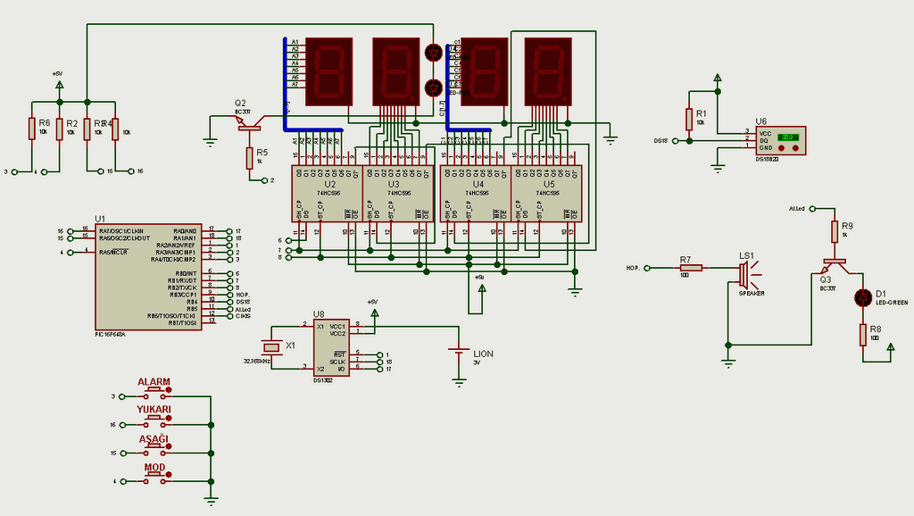

Project Features (@fhroz description)
The circuit includes functions such as clock, temperature (degrees), alarm, LED animations, and hourly alert sound (between 21:00 and 08:00).
The temperature value is displayed with 0.1 °C accuracy. The alarm is turned on and off using the UP button, while alarm settings are adjusted using the DOWN button. A melody plays when the alarm is active.
The PCB diameter is designed to be 25 cm, and an ARES PCB design suitable for these dimensions is available. Suitable enclosures for the circuit can be easily found in hardware stores or hobby shops. The displays used are 38 mm anode type. The PIC16F648A microcontroller is preferred.

Key Functions and Menu Usage
Pressing the UP key while on the clock display activates or deactivates the alarm.
Pressing the ALARM button enters the alarm settings menu.
Using the UP/DOWN keys, you can set the alarm time.
Using the MODE key, you can set the alarm minutes.
Using the UP/DOWN keys, you can also set the alarm minutes.
Pressing the MODE key exits the alarm menu.
Using the DOWN key enters the date settings menu.
Settings are made using the UP/DOWN keys; the MODE key moves to the next step or exits the menu.

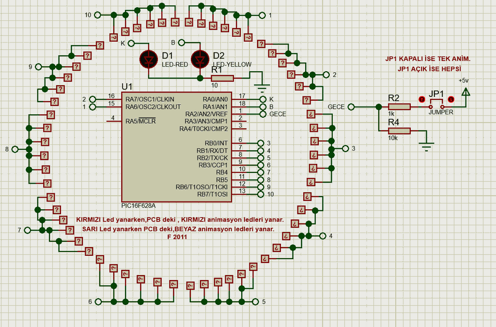

When the temperature rises below 21°C or above 29°C, a warning icon showing one degree per minute is displayed at the bottom of the displays (software controlled).
If the JP-1 is turned off while the LED animations are running, the system will switch to single animation mode (between 00-08) after all animations are completed.

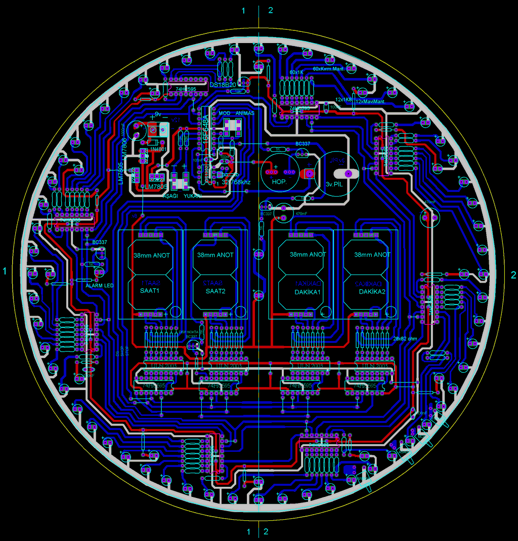

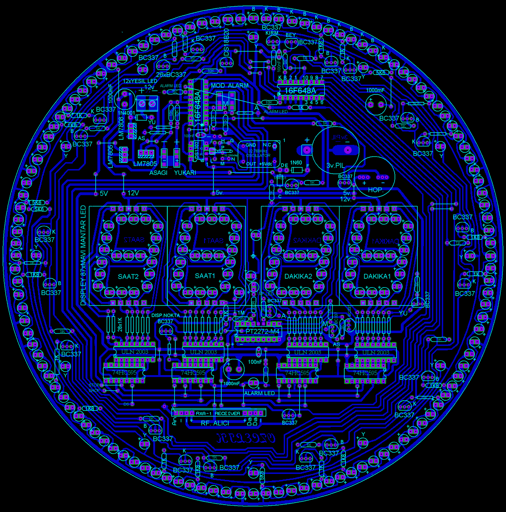

PCB Specifications
1. PCB – Main Clock PCB (25cm outer diameter round clock – 38mm anode display.LYT)
1-leiterplattenspezifikationen-aubendurchmesser-25-cm-runde-uhr-38-mm-anodenanzeige
This PCB forms the main body of the clock. It has a round design with a diameter of 25 cm and is suitable for 38 mm anode type displays.
The 8 74HC595 shift register integrated circuits that drive the animation LEDs around the display are designed to be mounted on the copper (bottom) surface.
This arrangement reduces cable clutter and provides a cleaner PCB layout.

RF Remote Control Support
RF Receiver Module:
PT2272-M4
18 pin socket
4 × BC337
330 Ω resistor
8 × 1K resistors
ROSC connections and LED
RF 4-Channel Transmitter: A ready-made module with PT2262 integrated circuit will be used. Pins 1–8 on the transmitter and receiver sides must be connected in exactly the same way.
On the PCB; M-M, A-A, YU-YU, AS-AS connections and RF receiver pin connections are pre-designed.
