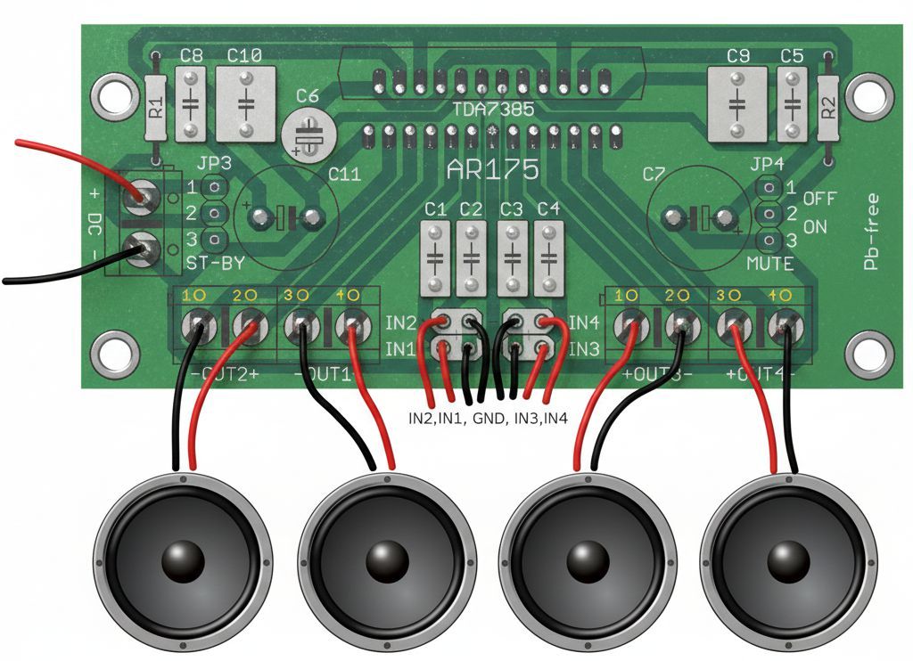

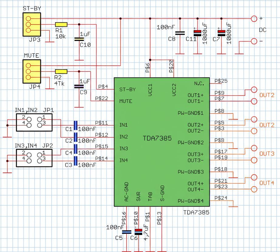

TDA7385 4-channel car amplifier circuit diagram
At the center of the circuit is the TDA7385 integrated circuit, shown as US1. This IC combines four bridge-output power amplifiers in the same package.
Each channel has a separate input capacitor and a separate speaker output pair. Since the outputs are bridge-connected, both terminals of the speaker are driven by the IC.
The TDA7385 operates in class AB structure. Unlike class D amplifiers, it does not require a high-frequency switching filter at the output; however, its efficiency is lower and the IC can heat up significantly. Therefore, a suitable heatsink is not optional in this circuit; it is a basic requirement.

Connection of the Audio Inputs
JP1 and JP2 connectors are used for the four channel inputs. In the schematic, the IN1, IN2, IN3, and IN4 inputs go to the TDA7385 input pins through C1-C4.
These capacitors have a value of 100 nF and block the DC component at the input. Thus, small DC offsets that may come from the source device are not transferred directly to the power stage.
Using shielded cable on the input line makes a difference in practice. Especially inside a vehicle, the ignition system, alternator, fan motor, and long cable routes can be sources of noise.
The signal ground should be connected to the power ground at the same point, and the input cables should not be routed for long distances parallel to the speaker and supply cables.

Standby and Mute Controls
Standby Input
JP3 controls the ST-BY input of the TDA7385. When the jumper is in the 1-2 position, standby is disabled and the amplifier becomes ready to operate.
If the jumper is moved to the 2-3 position, the ST-BY line is pulled to the passive state and the IC enters sleep mode.
R1 10 kΩ and C10 1 µF create a short delay on the standby line. This delay prevents the IC from turning on suddenly the moment the supply is applied.
Softening the startup sequence in power amplifiers helps reduce the disturbing “pop” sound coming from the speaker.
Mute Input
JP4 controls the MUTE line. When the jumper is in the 1-2 position, the sound is on; in the 2-3 position, the outputs are muted.
R2 47 kΩ and C9 1 µF prevent the mute line from changing level quickly and uncontrollably.
The mute input is used only to cut the sound; it does not turn the IC off completely. In systems that will not be used for a long time, standby should be preferred.
Mute is more suitable for source selection, startup waiting, or temporarily muting the speaker during testing.
SVR, AC-GND, and Grounding Points
The C6 4,7 µF capacitor is connected to the SVR pin. This pin is related to the reference voltage structure inside the IC, and if it is not filtered well, hum, background noise, or a turn-on sound pulse may occur.
It should be remembered that C6 is polarized, and its positive and negative orientation should be installed according to the marking on the PCB.
The C5 100 nF capacitor filters the AC-GND line. The schematic also shows that the TAB and S-GND terminals are connected to ground.
In multi-channel power ICs such as the TDA7385, routing the signal ground and power ground randomly causes noise.
In PCB design, high-current speaker returns and low-level input ground should be kept as separate as possible.

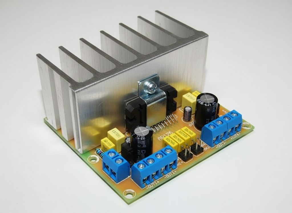

Points to Consider During Assembly
Starting assembly with low-profile components is the cleanest method. First, resistors and small capacitors can be installed, followed by electrolytic capacitors and connectors.
The TDA7385 should be placed on the board after it is fixed to the heatsink. Instead of forcing the IC legs to align, the mechanical fit should be checked first.
The orientation of electrolytic capacitors is important. If C6, C7, C9, C10, and C11 are installed in reverse, the circuit may not work; worse, the capacitor may heat up or be damaged.
Using a current-limited power supply during the first startup allows incorrect soldering or short-circuit faults to be detected before they become larger problems.
Suitable thermal paste should be applied between the heatsink and the IC. The electrical condition of the rear surface of the IC should be checked according to the package and application used, and it should be ensured that the metal heatsink does not touch another point.
First Startup and Test
In the first test, the correct polarity should be checked at the supply terminals before connecting the speakers. Then JP3 is moved to the operating position, and JP4 is moved to the sound-on position. If the IC does not draw excessive current, the speakers can be connected one by one.
A low-level audio signal should be applied to the input and the volume should be increased slowly. If there is no sound on one channel, first the related input capacitor, connector connection, and speaker pair should be checked. If all four channels are silent, the problem is generally on the standby, mute, supply, or common ground connection side.
