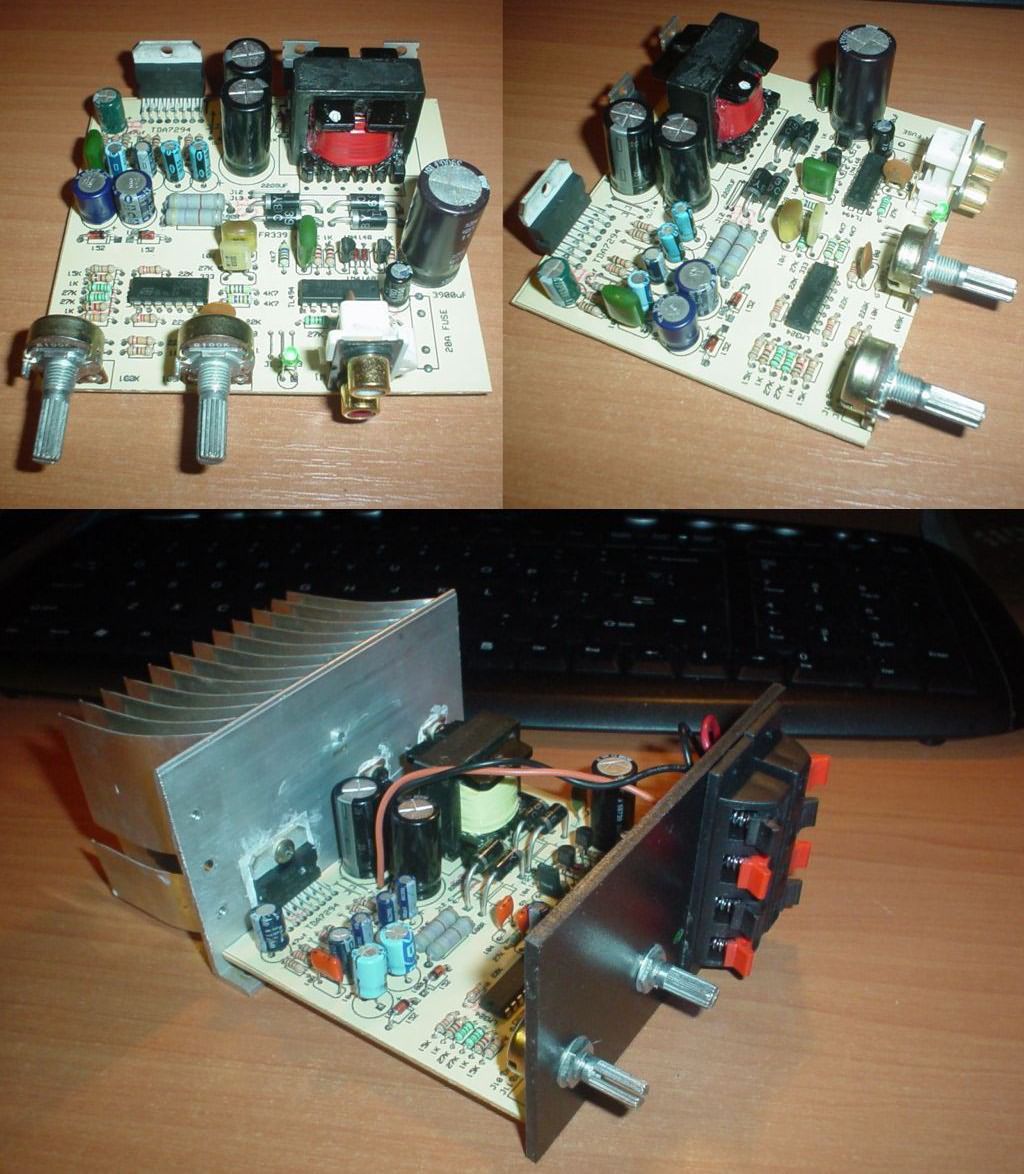

A TDA7294-based subwoofer amplifier design prepared for in-car use. The TDA7294 IC is used in the output stage, and the circuit can deliver approximately 100W level power. Since a high symmetrical supply is not directly available in the vehicle electrical system, the supply around +30V / -30V required by the amplifier is obtained with an additional DC-DC converter stage.
I had previously shared a similar project: TDA7294 Bass car amplifier TL494 SMPS supply. The PCB design of this project looks very good, so let it be included in the archive.
The TL494 is used in the DC-DC converter stage. TL494 is an easy-to-find and practical PWM control IC that has been preferred for many years in car amplifiers and various SMPS applications. You can find a significant portion of the parts used from old PC power supplies or some computer boards.
According to the source content, this amplifier is not a design tried for the first time; it is stated that similar applications have been made before and therefore no basic problem is seen in terms of reliability. It is an ideal circuit especially for those looking for a low-cost but functional solution in car subwoofer applications.

Since 12V DC is generally available in the vehicle environment, voltage boosting and symmetrical power supply generation are required for ICs such as the TDA7294 to deliver higher output power. For this reason, an SMPS stage that converts 12V to approximately +30V / -30V has been added. This method is one of the classic solutions seen in many car amplifiers. RFZ46 MOSFET was preferred as the power switching elements. This structure offers a very common and applicable topology for car amplifiers.
This type of converter built with the TL494 can operate quite efficiently with correct transformer winding and suitable MOSFET selection. The main purpose here is to boost the 12V voltage taken from the car battery and generate the symmetrical supply required by the amplifier stage. Thanks to the symmetrical supply, the TDA7294 can provide a more suitable output swing for driving a subwoofer.
It is stated that the transformer used in the circuit was removed from a computer power supply and recycled.

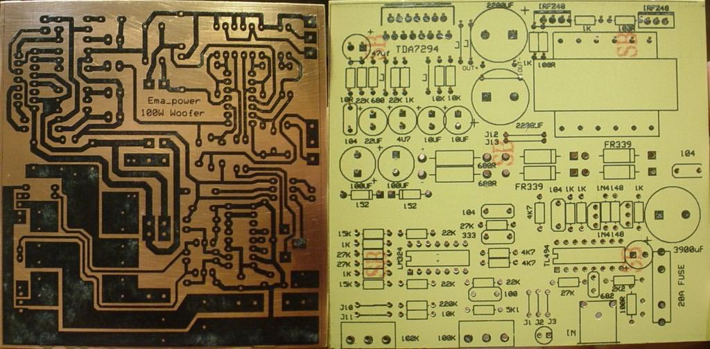

PCB Size and Drawing Program
tda7294 100w car subwoofer amplifier
According to the given information, the size of the printed circuit board is specified as 105 x 98 mm. This size is not considered very large for in-car applications and is relatively easy to place.
It is stated that the PCB design was prepared with the ExpressPCB program. ExpressPCB is a simple printed circuit design software frequently used especially in older amateur and hobby projects. For users who have this software, it may be easier to examine the existing layout logic.
