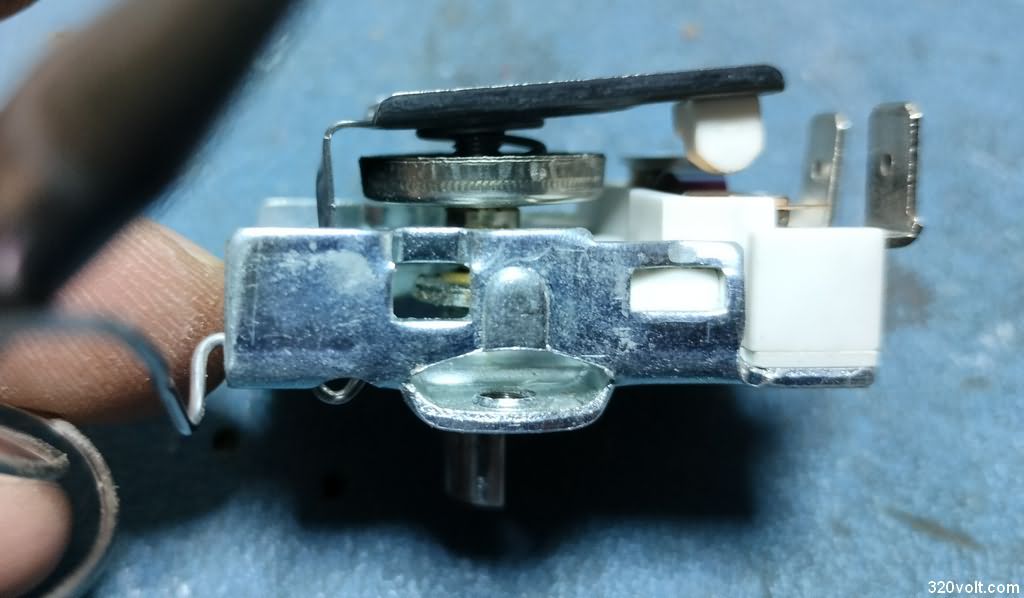

220V Thermostat Inspection
8-thermostat-review-pprc-welding-machine
9-disassembling-the-400v-thermostat-examining-internal-structure
10-pprc-kaynak-makinesi-thermostat-how-does-it-work
11-pprc-kaynak-makinesi-thermostat-how-does-it-work-contac
While I had the opportunity, I wanted to disassemble the 220V thermostat and examine its internal structure. Although I already knew its operating principle, it was nice to see that high-power control can be achieved with such a simple structure 🙂
The thermostat works on the principle that the material inside a small pin expands and changes consistency depending on temperature, or by using other materials that respond to heat. As a result of this expansion, the contacts open and close, controlling the power supplied to the heating element.
When I removed the contacts, I saw that they were seriously deformed. It was clear that the thermostat had reached the end of its service life. For a machine that has been used intensively in the field for years, this situation is quite normal.
