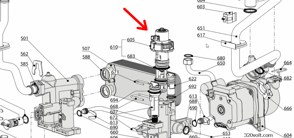

3-way valve structure in Ariston Cares Premium combi boilers
Ariston Cares Premium combi boilers service manual

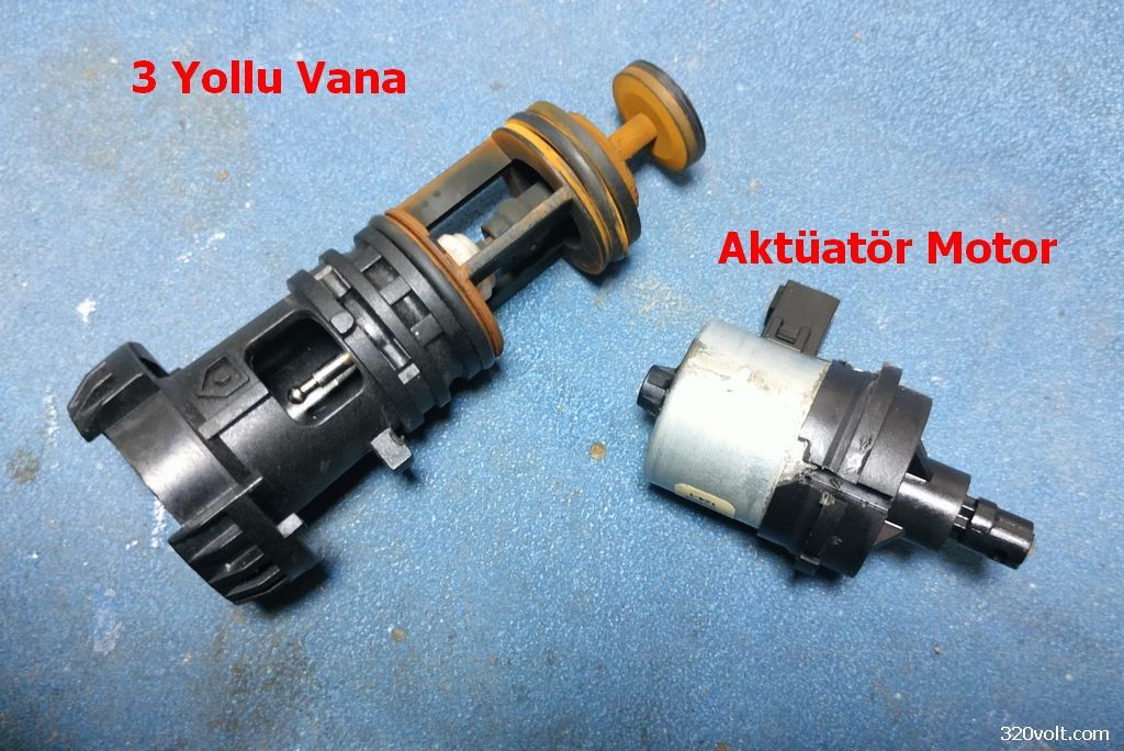

In the Ariston Cares Premium series, the 3-way valve system consists of two main sections:
  • Mechanical valve body with a long seal
  • Actuator motor operating with low voltage
While 3-way valve motors in some combi boilers operate with 220V AC, this model uses
a system operating with low-voltage DC.

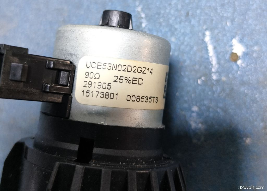

The following information is found on the actuator motor I inspected:
  • Model: UCE53N02D2GZ14
  • Winding resistance: Approximately 90 ohm

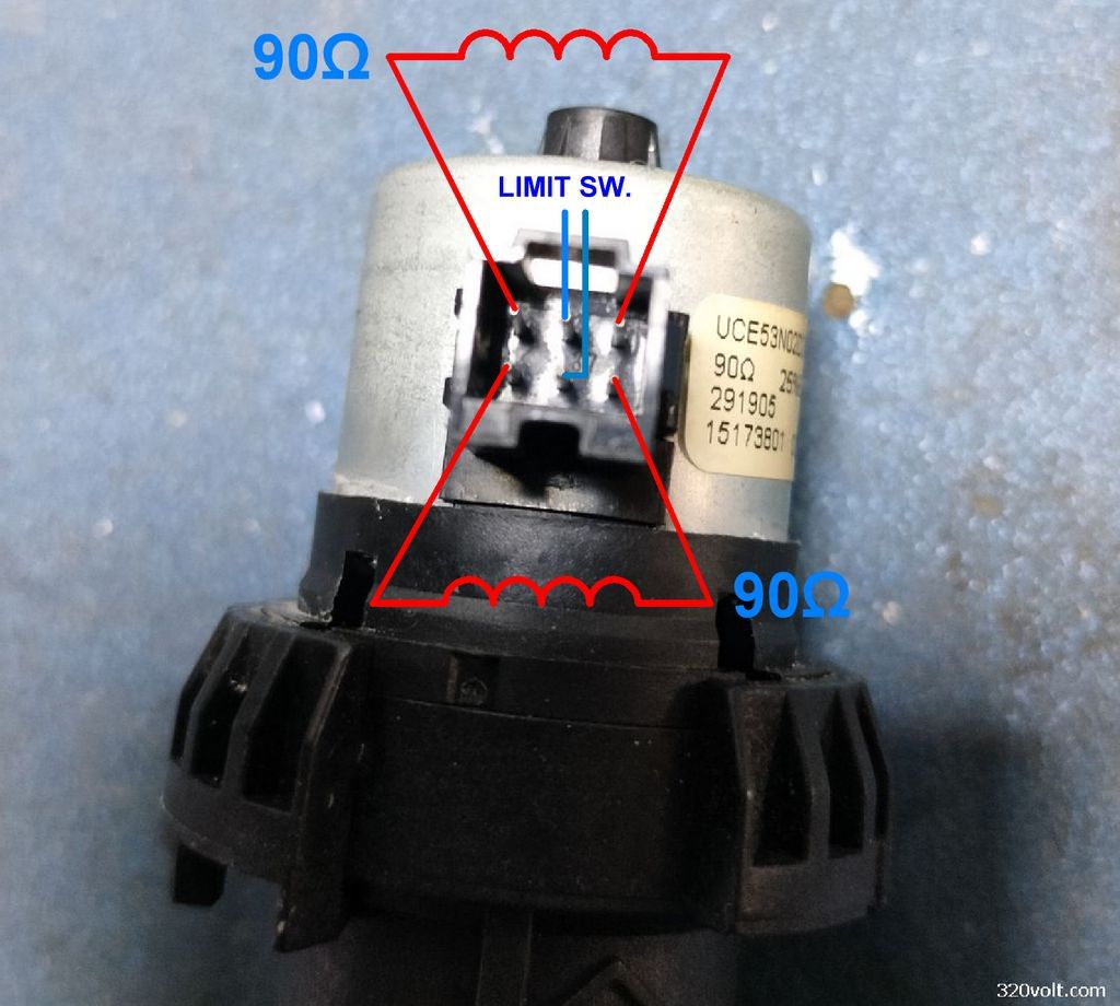

In the measurements I made with a multimeter, I saw that there were two separate windings on the motor and that both measured approximately 90 ohm. This indicates that the windings are intact.
No value appears when measuring resistance on the middle pins. These terminals are the connections to the limiting switch (limit switch) that detects the position of the valve.
Note: Although they have a similar structure, the middle terminals may not be a limiting switch in different brands and models; you should take measurements
combi boiler actuator motor limit switch UCE53N02D2GZ14 90 ohm

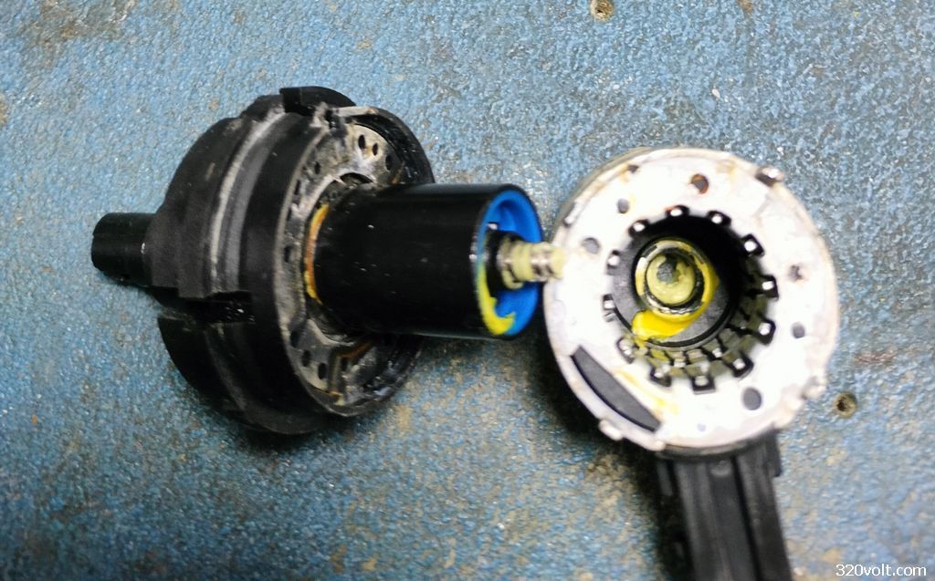

Combi Boiler 3-Way Valve Fault and Mechanical Inspection
If hot water is not coming from the combi boiler, the mechanical valve section must also be checked, as well as the motor.
  • Limescale
  • Rust
  • Dirt and sediment

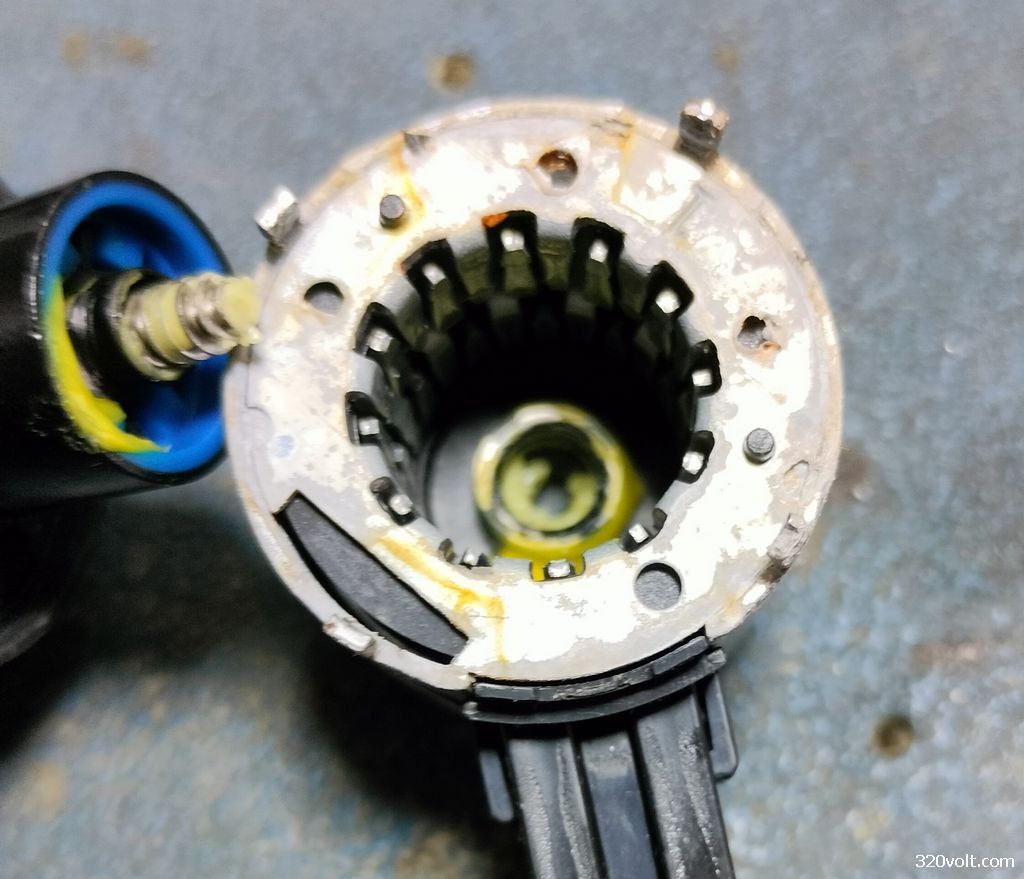

These factors cause the valve mechanism to jam. The jamming problem can be solved with good cleaning, but the seals may also need to be replaced; I do not know whether its seals are available on the market. Although suitable seals may perhaps be found in an auto industrial area.

According to the tests I performed, I think the actuator motor was intact 🙂 However, the mechanical valve section was seriously jammed, quite rusty, and its seals were not in good condition.
The service discharged the dirty water by applying air through the combi boiler and then replaced the complete valve assembly.
I am not a combi boiler technician; however, according to the tests performed, I believe this fault could have been fixed by replacing only the mechanical valve section.
In my opinion, by evaluating the motor and mechanical section separately during fault diagnosis, unnecessary part replacements can be prevented. But services replace the complete assembly without offering this option..
