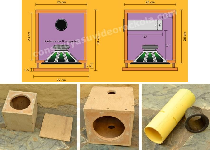

For bass, you should use a subwoofer with 30W RMS or more power. A size between 6 and 8 inches is recommended.
Good Sounding Subwoofer Cabinet Drawing
tda7377-2.1-subwoofer-amplifier-bass-box-cabined
