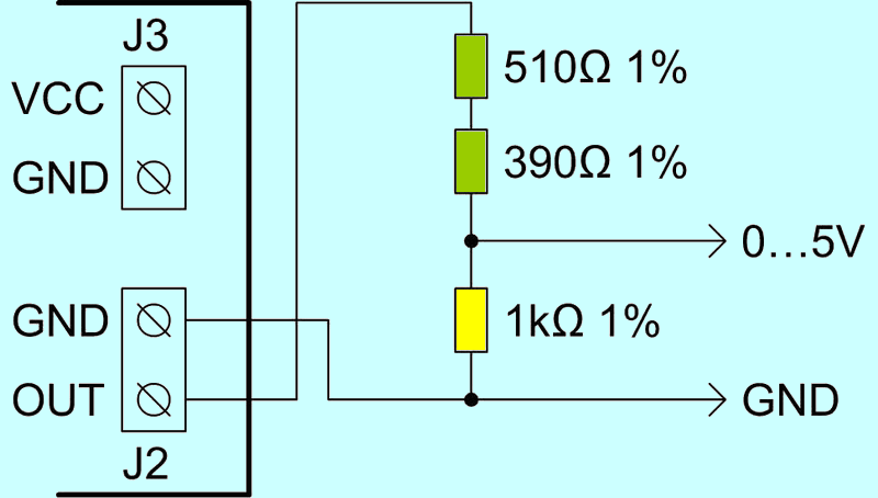

To ensure compliance with the 0.5V standard, the recommended component values ​​ensure a voltage division equal to 2, as the upper arm of this divider contains resistors with a total resistance 100Ω less than the lower arm.
The output resistance of such a device is 500Ω, which is sufficient for most applications, such as connecting to the input of a microcontroller’s analog-to-digital converter. Another modification can be made to this circuit. To ensure that the voltage output varies within the 0.5V range, simply replace resistors R3 and R4 with 30kΩ resistors with a 1% tolerance. The output resistance will then remain at 100Ω.
Example of connecting a voltage divider to achieve a 0.5V output voltage range:
example-connecting-voltage-divider-output-voltage-range-05v-plc
