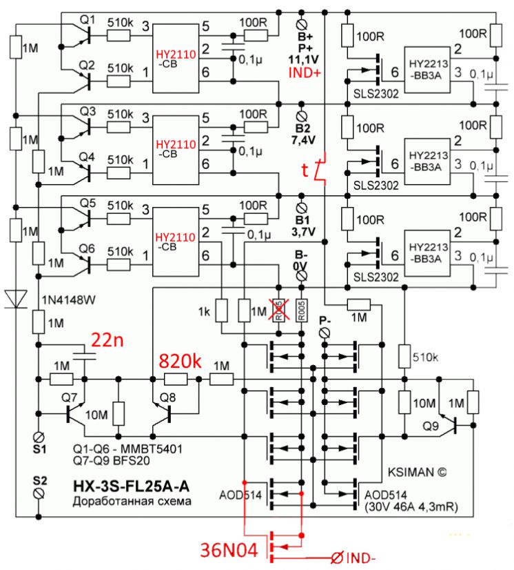

Modified 3S 25A BMS circuit schematic
bms 3s 25a schematic mmbt5401 bfs20 36n04 aod514 hy2213 sls2302

As a solution, a separate negative output is created for the battery indicator apart from the main P- line.
This new line is shown as IND- in the schematic. Thus, while the positive terminal of the indicator module remains at the pack positive, its negative terminal is connected not directly to P-, but to the IND- line created through the added MOSFET.
When protection is activated, this additional line also turns off and the indicator module is completely disconnected from the circuit.
As a result, the battery indicator no longer creates a continuously connected fake load at the BMS output.

Main sections in the schematic
Section Highlighted components Function
Cell protection monitoring section HY2110-CB, Q1-Q6 Monitors the voltage status of each cell group and forms the basic decision chain for overcharge and overdischarge protection.
Cell balancing section HY2213-BB3A, SLS2302, 100R, 0.1uF Manages the balancing behavior in cells approaching the end of charge.
Main power switching section AOD514 MOSFET group Controls the charge and discharge path by switching the main negative line of the pack on and off.
Additional switching for the indicator 36N04 Provides a separate IND- line to the battery indicator, ensuring that the indicator is completely disconnected during protection.
Auxiliary control and timing section Q7-Q9, 22nF, 820k, 1N4148W It is the auxiliary switching and timing section that shapes the control behavior of the added indicator line.
What do the main components used in the circuit do?
The three HY2110-CB units in the schematic operate in the single-cell protection IC class and are located in the section that monitors each series cell point separately.
HY2213-BB3A is an IC designed for cell balancing, and its OUT output is used in the balancing MOSFET drive logic.
The AOD514 MOSFET group controlling the main negative line forms the low-resistance power switching side.
The BFS20 transistors around Q7-Q9 should not be considered as power switches carrying the main current, but as auxiliary small-signal control elements.
Therefore, when describing this section, the expression “auxiliary control stage” is more accurate instead of “power transistor”.

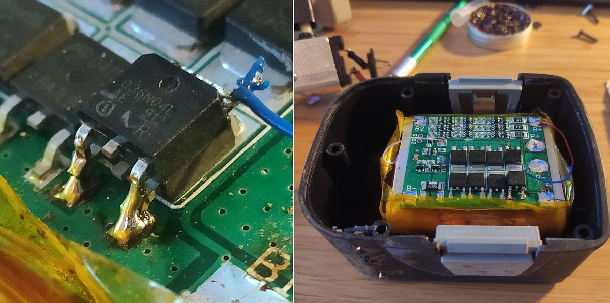

  • The negative terminal of the indicator module should not be left on the old P- connection; it should be moved to the newly created IND- line.
  • When soldering the added N-channel MOSFET, pad width, heat dissipation, and mechanical strength must definitely be taken into account.

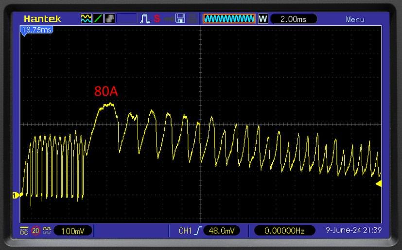

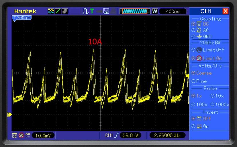

In the shared measurements, it is seen that high current is drawn at startup, while a lower but continuous operating current occurs under full trigger.
A noticeable drop in battery voltage at the moment of starting is an expected situation in drill motors.
The important difference here is that after the modification, the battery indicator line no longer remains in the circuit in a way that disrupts the protection behavior.
Startup current oscilloscope image
3s battery starting current drill motor oscilloscope measurement bms battery
Operating current oscilloscope image
bms 25a 3s battery operating current drill motor oscilloscope measurement
In the operating current section, the change in PWM behavior when the trigger is fully pressed shows that the circuit switches to a different operating mode according to load and drive conditions. For this reason, startup, full load, and protection moments should be evaluated together, not by looking at only a single oscilloscope screenshot.

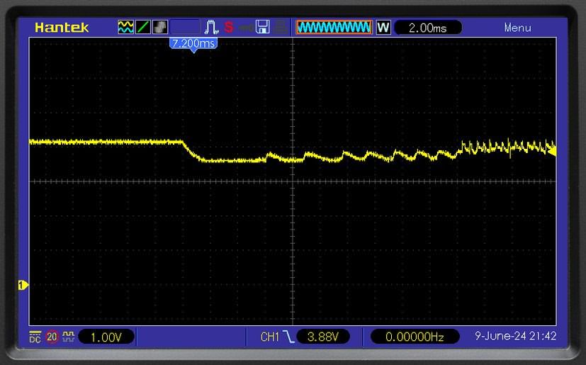

Battery voltage at the moment of operation
bms battery voltage during operation 3s battery drill motor oscilloscope measurement
