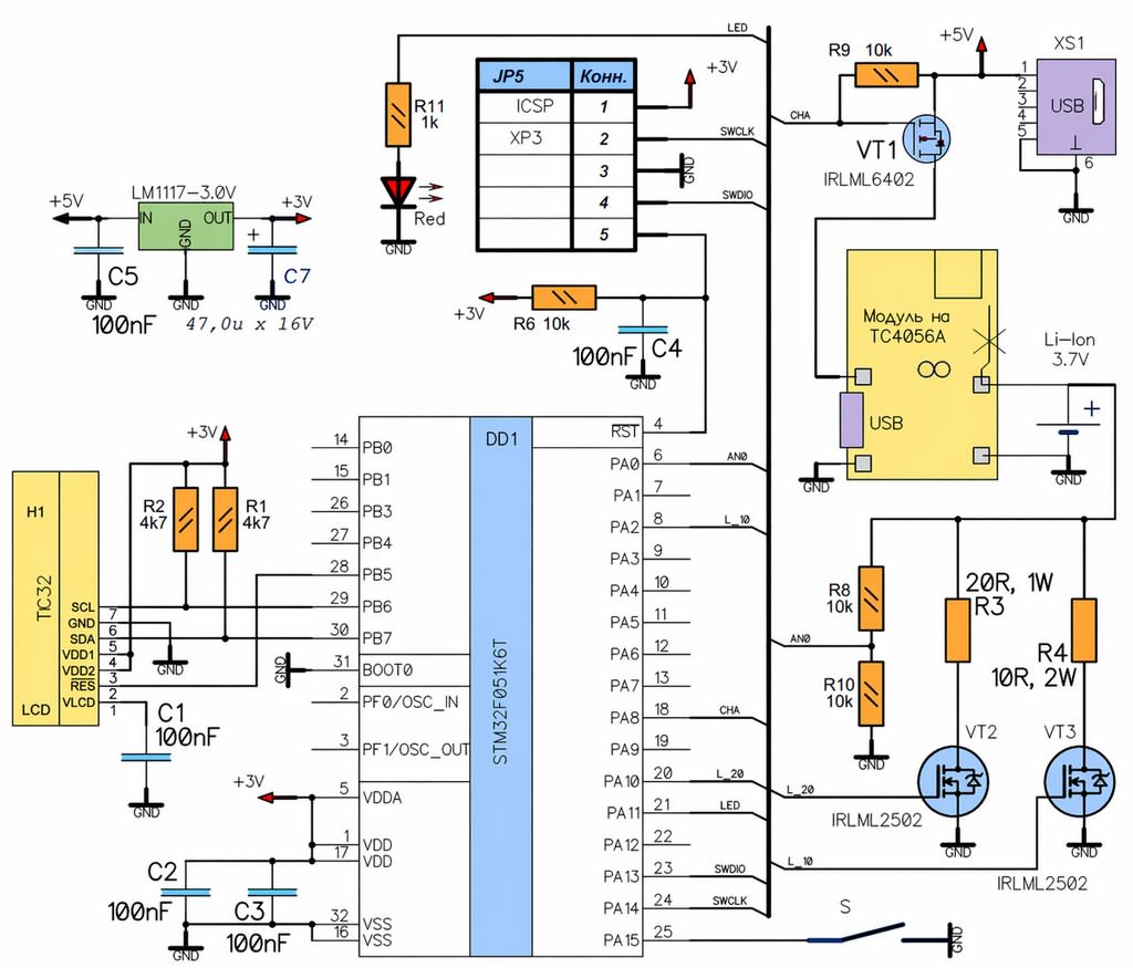

Operating principle of the Battery Capacity Meter Circuit
At the center of the system is the STM32F051K6 microcontroller shown as DD1. This microcontroller measures the battery voltage through the ADC, selects the connected load, runs the time counters, drives the LCD screen, and controls the mode transitions.
On the power supply side, 3V is obtained from the 5V input with LM1117-3.0. This 3V line powers both the microcontroller and the I2C-controlled LCD module. A 128×32 graphic LCD is used as the display, and the connection is made over I2C. R1 and R2 act as pull-up resistors here.
Charging the battery is handled with a separate logic. The TC4056A-based charging module seen in the schematic is used to charge single-cell Li-Ion/Li-Pol batteries up to 4.2V.
The charging path is switched on and off with the IRLML6402 P-channel MOSFET shown as VT1. The discharge loads are switched with the IRLML2502 MOSFETs shown as VT2 and VT3.
What do the main blocks in the schematic do?
It becomes easier to understand the circuit when it is divided into four parts.
- Power and regulation section: 3V is generated from the 5V input. The microcontroller and the display are powered from this line.
- Measurement section: The battery voltage is carried to the ADC input through the R8 and R10 divider.
- Discharge load section: The R3 and R4 resistors are selected through MOSFETs to apply a controlled load to the battery.
- Charging section: The TC4056A module and VT1 MOSFET allow the battery to be automatically switched to charging.
The important design choice here is this: there is no classic current shunt used in the circuit. The current is not measured directly; instead, the battery voltage is measured, and since the connected load resistance is known, the approximate current is calculated. This simplifies the circuit, but makes accuracy dependent on the actual values of the load resistors and how much they change as they heat up.
Load options and approximate current values
When the button is double-pressed, three different load levels can be selected. R3 and R4 in the schematic are used for this.
| Load mode | Equivalent resistance | Current around 4.2V | Current around 3.7V |
| Small load | 20 ohm | approximately 210 mA | approximately 185 mA |
| Medium load | 10 ohm | approximately 420 mA | approximately 370 mA |
| Large load | 20 ohm + 10 ohm in parallel, approximately 6.67 ohm | approximately 630 mA | approximately 555 mA |
This table also shows why the device is useful. It is possible to test the same battery at different currents and obtain results closer to real usage scenarios. For example, a cell that looks good at low current may drop faster than expected under a higher load.

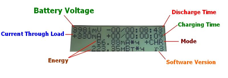

What information is shown on the display?
The display layout is quite useful. As far as can be understood from the images and description, the user can see several important pieces of information at the same time:
- Battery voltage
- Approximate current according to the selected load
- Discharge time
- Charging time
- Accumulated mAh value
- Accumulated mWh value
- Operating mode
- Software version
Since the time information is kept in day/hour:minute:second format, the display does not lose its meaning in long tests either. This is a useful detail especially in capacity tests performed at low current.

Short notes about the components in the schematic
STM32F051K6 is an appropriate choice for this task. It offers the necessary peripherals such as ADC, timer, and I2C in a single package. Operating it with the internal oscillator keeps the circuit simple.
LM1117-3.0 is an easy solution for obtaining 3V with a small number of components. However, since the input is 5V and the output is 3V, some heat may be generated on the regulator. Since the consumption is low, no major problem is expected, but it should still be taken into account in very tight enclosures.
Using logic-level MOSFETs such as IRLML2502 for load switching is the right choice. Since they can be driven at around 3V, they can be controlled directly with STM32. IRLML6402 offers a suitable P-channel MOSFET solution for switching the charging path from the high side.
