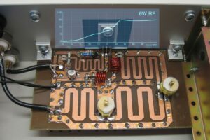

All SMD components are soldered directly to the top surface of the PCB.
In the RF stage, leaving long leads, moving components with wires, or placing trimmer capacitors away from the board is not suitable.
Especially the connections of the 70 pF adjustable capacitors should be short, and they should not move mechanically during adjustment.
Component-assembled PCB of the 6 Watt FM RF amplifier
6 watt fm rf amplifier component assembled on pcb
  • The bottom ground plane and the ground points on the top surface must be connected with many vias.
  • The 2SC1971 body must be tightly fixed to the heatsink.
  • The supply cable should be kept short and routed away from the input and output RF cables.
  • The chassis connection of the input and output BNC connectors should have a wide surface.
  • Adjustable capacitors should be selected from types suitable for operation in the VHF band.
  • Care should be taken that the transistor is not counterfeit or a low-quality equivalent.
In RF power circuits, soldering quality is more effective than it appears.
A cold solder joint or cracked via connection may not be noticed at low frequency; around 100 MHz, however, it can noticeably reduce the output power.
First Startup and Adjustment
In the first test, a suitable-power 50 ohm dummy load should be connected to the output instead of an antenna.
If an RF wattmeter is available, output power and reflected power should be monitored together.
If an RF wattmeter is not available, a suitable-power small bulb can be used temporarily for rough adjustment, but this method does not provide precise impedance measurement.
  • First, connect the 12 V supply without applying RF input and check whether there is excessive current.
  • The circuit must not be operated without connecting a 50 ohm dummy load to the output.
  • The FM exciter is started at low power, and the input level is increased slowly.
  • After the operating frequency is selected, the 70 pF adjustable capacitors are adjusted for maximum output and low reflection.
  • The transistor temperature is monitored during adjustment.
  • Before long-term operation, the output spectrum and harmonics should be checked.
The approximately 300 mW input level is the value specified for this design. Driving it harder may lead the transistor to saturation, heating, and unwanted harmonics instead of making it more powerful.
With lower input, the output power naturally decreases. In similar RF applications, the cooling and impedance-matching logic in RF power amplifier designs for different power levels can also be compared.
