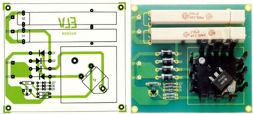

The audio signal at the tweeter terminals is rectified by the D1–D4 SB360 fast diodes acting as a bridge rectifier and applied to the series structure consisting of the R3 150-OHM resistor and the D5–D7 reference diodes. At this point, when the reference voltage generated by the D5–D7 diodes exceeds approximately 0.6 V, current flows through R4 to the base of the T1 BC558C transistor.
When the T1 BC558C conducts, the Darlington power transistor T1P142 T2 is driven via the R5 150-OHM. T1P142 conducts, preventing the reference voltage from rising further, thus stabilizing the voltage generated through R3 and D5–D7.
As a result of this mechanism, the peaks of the AC signal on the tweeter are clipped from a predetermined voltage level. This provides highly effective overload protection for the tweeter.

First, determine the desired power level at which the protection should activate and select diodes D5, D6, and D7 accordingly.
Then, diodes D1–D4 are installed and soldered. After each soldering operation, the excess leads should be trimmed as short as possible.
Next, resistors R3–R5 and transistor T1 are mounted.
Next, the T2 T1P142 Darlington power transistor, with its middle leg cut off, is secured and soldered using M4 screws and nuts along with a finger-type heatsink.
In the final stage of assembly, the connection pins and high-power resistors are installed.

When placing the circuit in the speaker cabinet, sufficient heat dissipation must be ensured. The tweeter connection is disconnected, and the wires from the crossover are connected to terminals ST1 and ST2. The tweeter itself is connected to terminals ST3 and ST4.
To avoid phase error, the following point should be noted:
If the wire from the crossover, which was previously connected to one end of the tweeter, is now connected to ST2; the same end of the tweeter should be connected to ST4.
