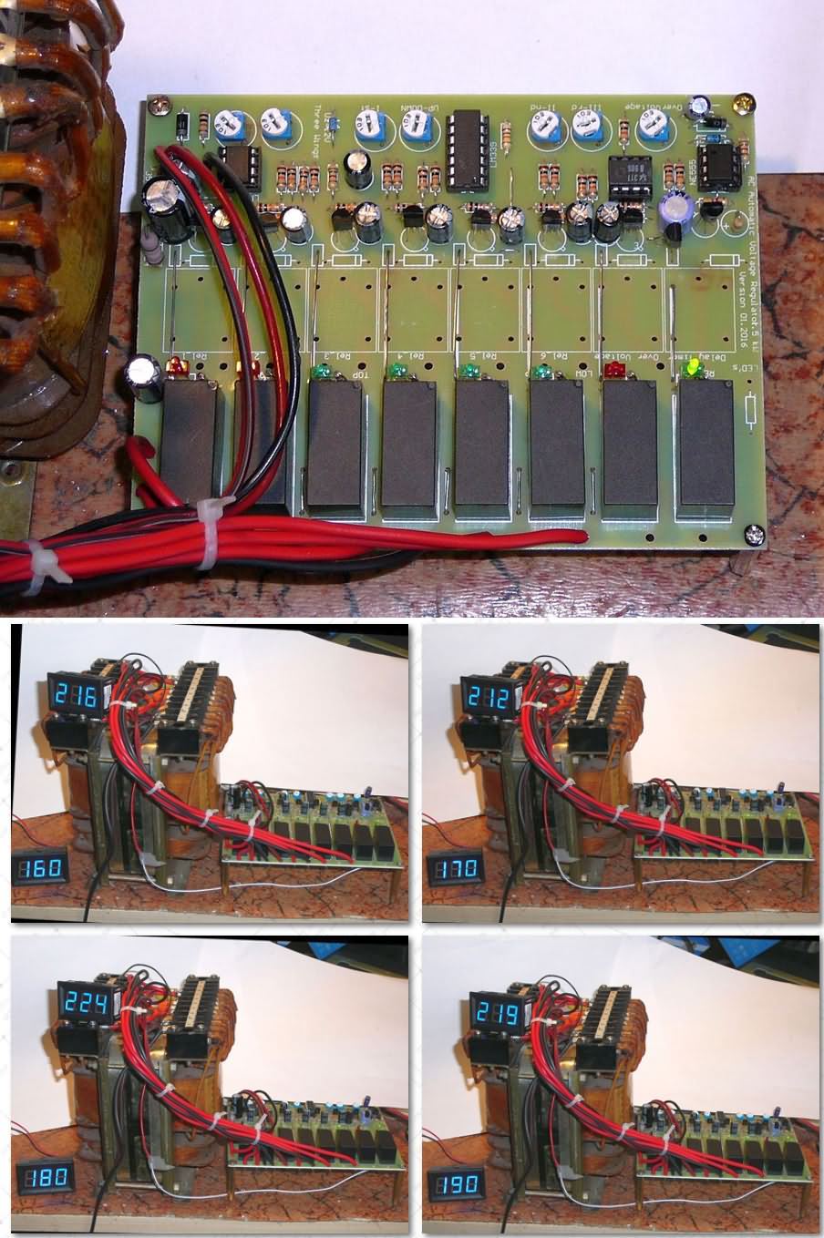

  • Relay–Transformer Voltage Regulator Stabilizer
  • Relay–Transformer Stabilizer – 2
  • Relay–Transformer Stabilizer – 1200 W
  • Relay–Transformer Voltage Regulator Stabilizer – 2000 W

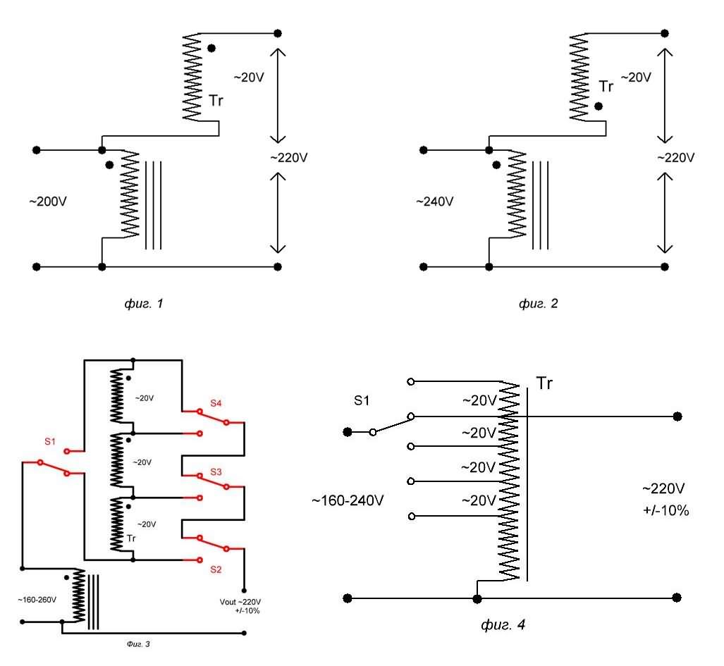

Stabilization Based on the Volt-Add Principle
From an implementation point of view, the easiest solutions to realize are electronic stabilizers.
These are generally not high-power; however, they have a notable advantage:
The load power can be 4–7 times higher than the rated power of the transformer used.
For example, with a 250 W transformer, an electronic stabilizer capable of supplying a load in the 800–1500 W range can be designed.
How is this possible?
The basic principle is to add voltage by connecting the low-voltage, high-current secondary winding of the transformer in series with the primary winding.
If the secondary winding is connected in phase with the primary, it is added to the mains voltage (boost).
If it is connected in reverse phase, it is subtracted from the mains voltage (buck).
This method is called the volt-add principle.
What needs to be done after this point is to control this connection electronically.
The simplest approach is to build a system that operates only as a booster without changing the direction of the secondary winding. This is because, in practice, the most common problem is a drop in the mains voltage.
For example, while the input voltage varies between 150–200 V, the target is to keep the output within the 220 V ± %10 (200–240 V) range.
Boost and Buck Operating Logic
relay-type-transformer-mains-voltage-stabilizers-220v-230v-110v-180v-170v
When the primary and secondary windings are connected in series:
A mains voltage that has dropped to 200 V can be increased to 220 V with a 20 V secondary voltage.
If the same windings are connected in reverse, the mains voltage is reduced by 20 V.
This structure essentially behaves like an auto-transformer.
However, a real mains stabilizer must be able to operate in both boost and buck modes.
The most practical way to achieve this is to swap the secondary winding terminals using electronically controlled relays.
This approach leads us to the concept of relay–transformer stabilizers.
Step Voltage Regulation
relay-type-transformer-stabilizer-2000w-1200w-220v-ac-voltage
If the transformer has multiple secondary windings and these are selected by relays:
10 V
20 V
or step voltage regulation at any other desired value can be performed.
In this way, for example, a system that operates in the 150–260 V range and keeps the output at 220 V ±10 V accuracy can be obtained. This ±%5 accuracy is more than sufficient for household devices.
Of course, one of the relays must be used to change the direction of the secondary winding.
In homemade systems, considering that most electrical devices are already designed to operate within the 220 V ±%10 range, a 20 V step interval is generally sufficient. Step selection is not standard; it depends entirely on the designer’s preference.
In some circuits, unusual values such as 14 V, 15 V, and 17 V can be seen. The reason for this is the desire to apply a large voltage addition during large voltage drops and to make finer adjustments for small deviations.

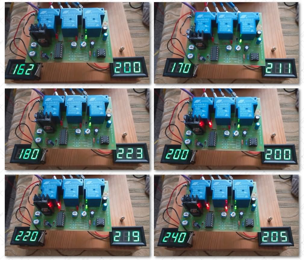

Relays are generally controlled by comparator circuits. This is the simplest and most reliable method for amateur applications. In commercial products, microcontrollers are mostly used.

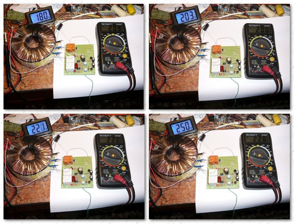

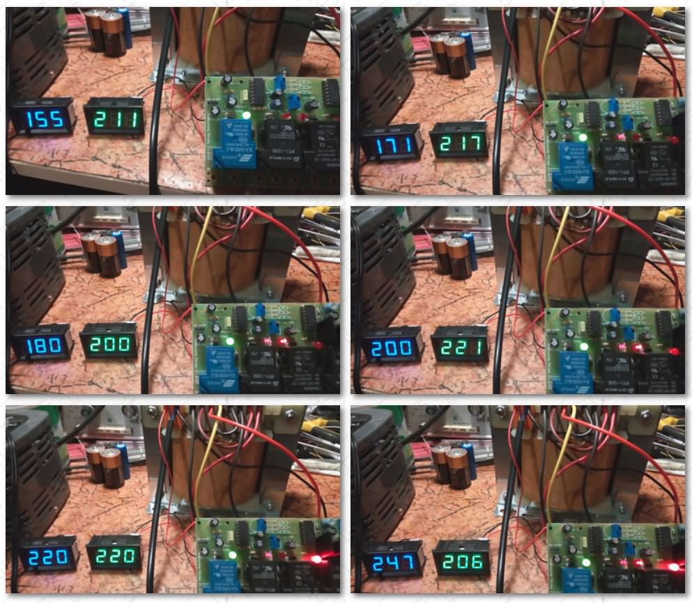

Why Was the Relay Method Adopted?
relay-transformer-based-mains-voltage-stabilizer-threshold-detector-circuits
The main factor limiting the output power in the electronic stabilizer was the power rating of the MOSFET. In the relay method, however, the load is applied directly to the transformer windings, and semiconductors do not become the limiting factor.
Of course, arcing may occur at the relay contacts; however, this problem can be eliminated with a suitable arc-suppression (snubber) circuit.
For this reason, relay–transformer stabilizers are the most widely used solutions in household applications up to 4–5 kW.
