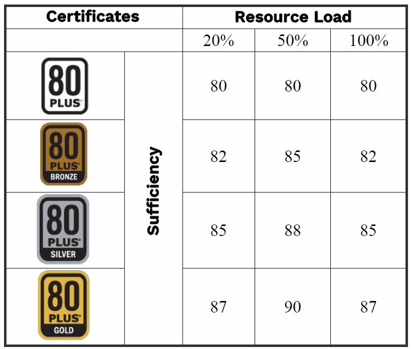

In 2003, an organization was established to promote higher efficiency in power supplies used in computing and multimedia technologies. Based on tests conducted by the 80 Plus organization, certifications are awarded to power supplies with efficiency higher than 80%.
Various versions of the certificates are available. Certification of resources based on efficiency;
80 plus certification power supply
The power supplies were tested for either 115V ±1% or 230V ±1% input voltage. Power supplies with higher input voltages will have higher efficiency due to lower input current. Measurements are performed for different loads of 20%, 50%, and 100%.
Minimum efficiency limits are set for each load; these limits must not be exceeded, otherwise the power supply’s efficiency will not reach the specified certification.
80 PLUS Certification
Another requirement for obtaining 80 PLUS certification and above is a power factor of cosP 0.9. The advantage of using such certified power supplies is primarily savings in operating costs, lower heat generation and consequently higher reliability, lower cooling requirements, and lower noise.
Ultimately, it is necessary to evaluate whether the aforementioned advantages outweigh the high price. Power supply selection is also important. It is preferable that the power supply and the device’s power consumption are similar. The disadvantage of 80 PLUS certifications is that they don’t consider the power consumption in standby mode. In this case, power consumption can reach up to 10W.
