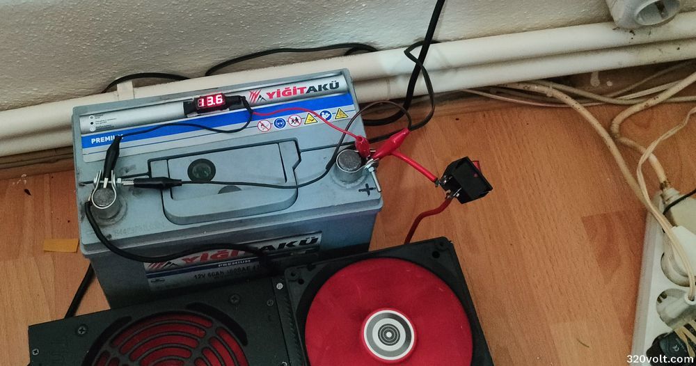

Can a car battery be connected to a UPS?, Can a car battery be charged with a UPS?, Installing a car battery to a UPS. I was using a small 4Ah battery UPS uninterruptible power supply for my computer, a large 4-battery UPS power supply for cameras, TV and the lamp I use in a power outage. I also have a spare UPS inverter that I connect to the car battery to get electricity for a longer time.
A mixed, messy system that has formed over time since I got involved in battery desulfator work 🙂 I said it would be enough if I just used the uninterruptible power supply that I used the car battery for, I had to organize the installation accordingly and modify the UPS power supply. The spare device that I use the car battery for is more recently developed compared to the other 4Ah battery and 4 battery… but its case is plastic, especially in devices like UPS, I don’t like the use of plastic cases, it doesn’t seem safe. (I need to put the battery in a metal case later….)

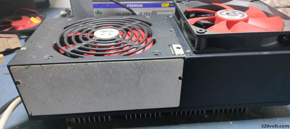

What to do for UPS Modification;
  • 1 I need a metal case.
  • 2 I need to cool the mosfets better
  • 3 I need to cool the transformer
I combined 2 PC power supply boxes for the metal case. The screwed parts to the PC case match each other when combined with a nut screw, it becomes a big box without any problems in terms of appearance and durability, you can make cuts from the joint section inside and use it as you want.
It will be very difficult to add to the cooler of the mosfets, there are 4 mosfets, 2 of them have isolators, the others do not, so the cooler I will add should not touch the case or I need to remove the mosfets and install an isolator, since I will use a fan in any case, I said I do not need an additional cooler, the fan will be enough. (test ok.)
The transformer was mounted to the plastic case of the device with sheet metal clamping screws, so they did two jobs at once, I removed these screws, added a mounting iron to the bottom and fixed it with a nut screw. I used a fan inside the transformer, but I had to mount the fan outside the case, the transformer did not save the size.
I used a 5V output SMPS adapter to operate the 12V fans, there is no noise since they work at low speed, they blow enough with 5V. In addition, I placed 4 aluminum coolers under the case, I had noticed before, the transformer was overheating, I added it just in case, this problem disappeared. Also, the value of the capacitor at the 12V battery input is 1000Uf, I changed it to 2200Uf.

Yes, the tricky part is connecting a car battery to the UPS uninterruptible power supply. First of all, my inverter has a single battery and a charging voltage of around 13.6v. This voltage is enough to keep the battery in floating charge. SLA lead acid batteries should be kept constantly charged anyway..
The problem will be the charging current. It gives a charging current between 700mA…1A. It will take a few days for the dead car battery to charge, but if it doesn’t, I can charge it with an external charger in a few hours. For this, I am thinking of modifying an SMPS adapter and adding a small voltmeter. (I added the voltmeter module, it was great…)
Finally, there is the issue of harmful gas discharge from the battery, @taydin teacher Using a car battery with UPS (https://mekatronik.org/forum/threads/ups-ile-araba-akusu-kullanmak.2107/) tested it in the project, made measurements, did not experience any problems, and this question was solved thanks to it. Thank you.

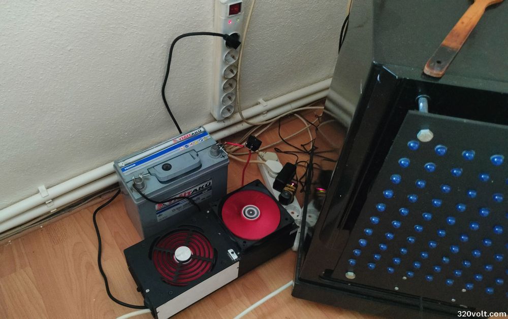

Yes, as you can see in these pictures, the system was as I wanted, including the metal case, fan, cooler, etc. I made a 15A dual switch connection to cut the battery’s attrition line when necessary, combined the two ends and increased the power of the switch, thickened the battery cables and kept them as short as possible.
