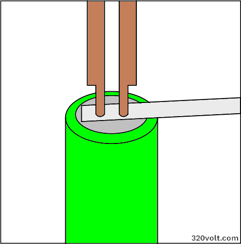

The Arduino spot welding machine works by sending high-current pulses. A superior feature of the Arduino spot welding machine board compared to classic battery spot welding circuits and methods is the application of two current pulses.
The first current pulse softens the nickel, ensures better contact between the probes, and burns away oxide and dirt from the nickel; this is a short pulse.
The second, longer current pulse enables the welding process. In other words, the first current pulse allows for a solid spot weld with the second current pulse. We see it as a single current pulse, but there are actually two.

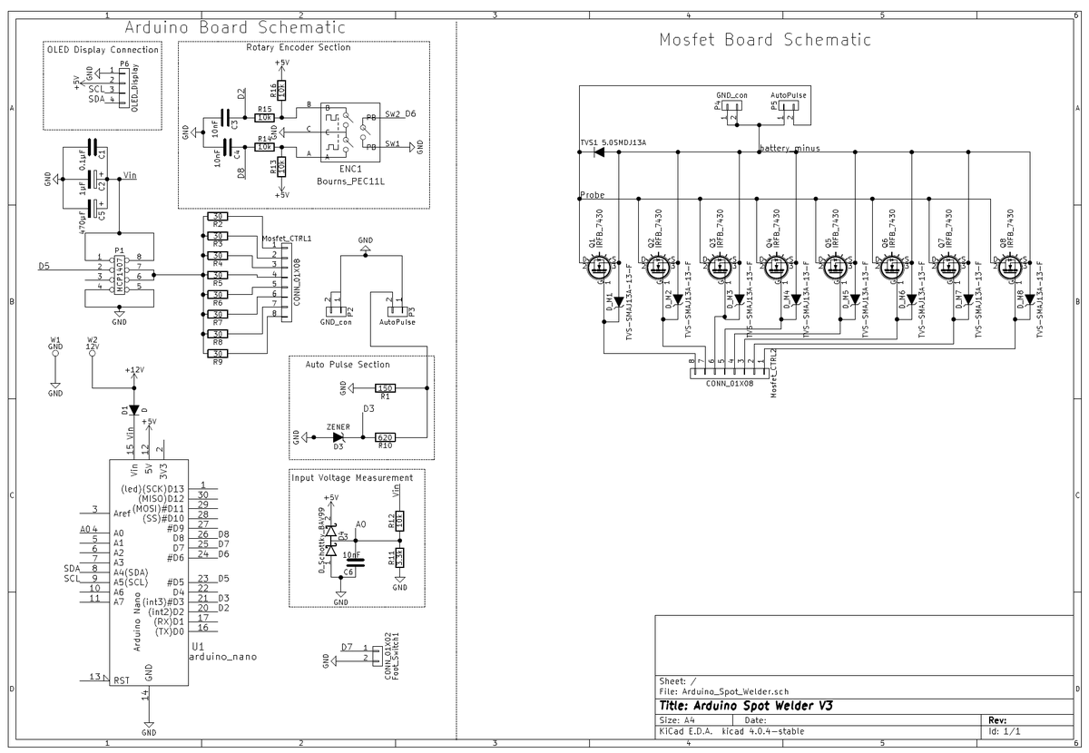

Arduino Spot Welding Battery Spot Welding Circuit Diagrams (v3, v4)
circuit-schematic-diy-arduino-spot-welder-v3
circuit-schematic-diy-arduino-spot-welder-v4
