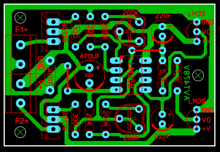

Operating Principle of the Heat Fan Speed ​​Control Circuit
The 12V DC fan speed control regulator is an effective and reliable solution for all electronic applications requiring temperature-focused cooling. The circuit consists of two function blocks of the same structure. At the center of each block is the LM358 operational amplifier.
This amplifier increases the voltage from the temperature sensor to the level determined by the R4–PR1 (or R8–PR2) resistors.
LM35 type temperature-voltage converter sensors are used for temperature measurement. The LM358 operational amplifier output is applied to the BD139 driver transistors T1 and T2. The voltage at the emitter end of the transistor is the same as the amplifier output.
Therefore, the fan theoretically receives approximately 11.3V instead of 12V; however, this difference does not create any practical problems.
When the power supply is first applied, all components are at ambient temperature and the amplifier output is approximately 6V. While this voltage is sufficient for the fan to operate at low speed, it may not provide the initial start.
Therefore, the circuit briefly supplies the fan with a full 12V at startup, ensuring a reliable initial start.
A full voltage for the initial start is important because some fans cannot start with a low voltage. They work without problems after the initial start, but they may not work if the initial voltage is low.

LM35 Fan PCB Design
Note: The PCB design was created using Sprint Layout 6, checked but not tested.
pcb-layout-lm35-lm358-12v-fan-speed-control-regulator-circuit
