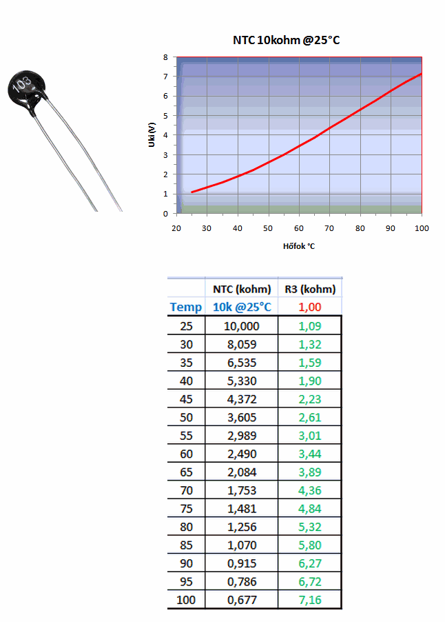

The protection relay is not built into the PCB; you can use it by connecting the relay. A 10K NTC is used for temperature measurement. The nominal resistance of the NTC is given at 25°C.
Temperature-Resistance Values ​​of a 10K NTC
10k ntc temperature values 10k ntc sicaklik degerleri
The Tmax temperature value will be determined by the Ref-Hi voltage value, which is the sum of the voltages across resistors R6 and P1, i.e., the Ref-Out voltage value.
As we know, there is a voltage drop of 1.25V across resistor R6. If P1 is short-circuited (no voltage can drop across it), the Ref-Out (minimum) voltage value will be 1.25V. If P1 is wound to its maximum, the voltage drop across U P1 is determined by I ref * P1. The I ref value is 0.668mA (because the ADJ current also flows through the P1 trimmer). Therefore, the voltage drop across P1 U P1 = I ref * P1 = 0.668mA * 10kΩ = 6.68V. Furthermore, there is a voltage drop of 1.25V across 2.2kΩ. Therefore, the Ref-Out (maximum value) can be 7.93V.
The NTC table indicates the temperature at which the Tmax value can be adjusted. The range between 30 and 60°C is approximately 1.3 to 3.5V, so it can be seen that the Tmax value can be adjusted over a wide temperature range. This voltage can be measured at pin 6 of the LM3914 and converted to temperature using the table.

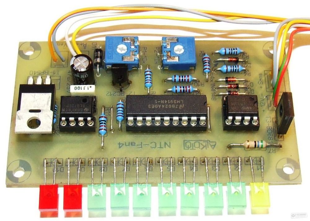

Temperature Display
The LM3914 LED driver integrated circuit (IC) was used, assuming the fan speed and temperature are set to the voltage range Tmin – Tmax (temperature). The LM3914 can switch ten LEDs in linear steps depending on the input voltage if the input voltage is between Ref Lo and Ref Hi.
The temperature display divides the Tmin/Tmax temperature range into 10 discrete points. (More accurately, 9+1 points, since the 10th LED will activate the protection relay.) Regulation will not be a continuous, monotonically increasing function, but the fan voltage will also consist of 10 points between 4 and 12V.
Since an “initial voltage” of approximately 4V must be provided immediately upon the first LED being turned on for the fan to operate, the BD681 Darlington transistor is used as a “voltage level shifter” circuit. This essentially acts as a “high-current” Zener diode. When LED1 is turned on, the 1.2V voltage of the two series bases appears on the BD681 Darlington transistor, and as the current increases (when the LEDs are turned on in series), the voltage drop across the transistor no longer increases. The sum of the voltages across the shunt resistor and the Darlington will be the control signal for the DAC control amplifier stage. All we need to do now is increase this DAC voltage change to the 4.12V range for the fan.
