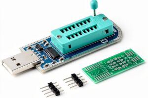

Hardware Structure
The Minpro I V1.3 board does not have very complex hardware.
The main structure consists of the CH552G microcontroller, USB connection, ZIF socket, SOIC adapter connections, a few passive components, and lines that manage the memory supply.
Although it looks simple, special attention is required especially for the logic level issue.
ch552g microcontroller usb connection zif socket soic adapter connections

5V and 3.3V Logic Level Issue
One of the most important technical points of the board is the CH552G power structure. In the source circuit, 5V from the USB line is applied to the internal regulator input of the CH552G, that is, the VCC side.
The V33 output is filtered with a capacitor. This structure is compatible with the CH55x datasheet logic; however, it should be considered separately in terms of the logic levels going to the memory ICs.
minpro i 5v and 3.3v logic level
When the I/O stages of the CH552G operate connected to the 5V side, signal levels close to approximately 5V may occur at the memory inputs.
Since some 24xx and 25xx memories have 5V-tolerant inputs, this may not cause a problem.
However, direct connection is risky especially with modern 3.3V SPI Flash or 1.8V Flash memories.
Memory Type Typical Supply Point to Consider
24xx EEPROM 3.3V or 5V The model’s 5V tolerance should be checked through the datasheet
25xx SPI Flash Generally 3.3V 5V logic level may cause permanent damage in some ICs
1.8V SPI Flash 1.8V A 1.8V adapter or suitable level shifter must definitely be used
For the CH552G, the way to pull input/output levels to 3.3V according to the datasheet is to use pin 15 VCC and pin 16 V33 appropriately and provide supply from an external 3.3V regulator.
However, this change may affect the firmware update side; because in some cases there is a 5V requirement on the VCC line for the controller to enter programming mode.
Therefore, if the board will be modified, not only the memory read-write side but also the DFU and firmware update side should be considered together.
