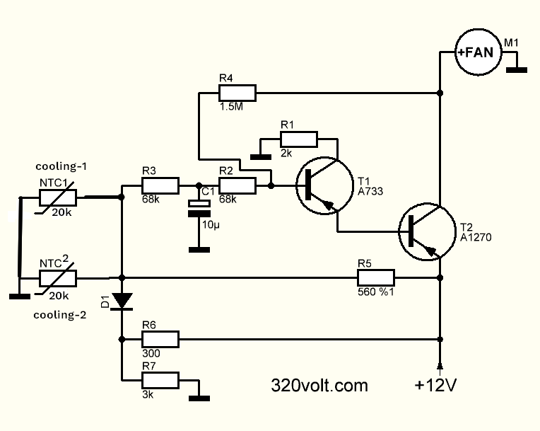

A circuit PCB design that adjusts the fan speed according to the temperature was made as small as possible, most of the components are SMD, in addition to the fan control circuit I share in the PCB drawing I prepared for DIP components.
Fan control circuit; Amplifier, power supply circuits etc. The fan control circuit, which can be used in many power applications requiring cooling, automatically increases the fan speed according to the cooler temperature. Thus, the fan is long-lasting and does not make a lot of noise unnecessarily full speed.
Actually, there were much simpler circuits, but we used this circuit because it was ready and we had no problems with our experiments. I copied the circuit from a quality ATX power supply, it is used in a few devices, in fact, a complete SMD design would be made, but this was more than enough.

NTC Fan Control Circuit Diagram
NTC FAN CONTROL

    What is the output power limit of this circuit?
    Reply
      Hi, I tested it with 120 mA and had no problems. It can deliver higher current according to transistor power
      Reply

    Please can you make a circuit if my amplifier circuit is two channels on two separate heatsinks but they share only one fan for cooling. So meaning two heat sensors to control one Fan.
    Reply
      Hello, use two 20k ntc;
