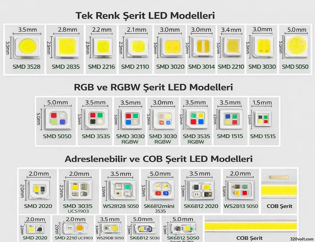

Şerit Ledlerde Kullanılan LED Modelleri
led strip models common types of led strips
