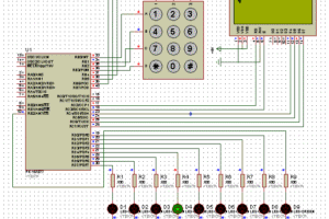

Uygulama devrelerinden Örnekler
keypad_kod_devresi_f877pwm_kullanimi_protonledleri_yak_sondur_pic16f84pic16f84_buton_bas_birakproton_display_uygulamasi
proton_keypad_pic16f84proton_ledli_karasimsekproton_ledli_karasimsekproton_makina_pic16f877proton_pic_lcd_uygulama
proton_timer1proton_toggle_led_efektproton_toggle_led_efektproton_while_wend
