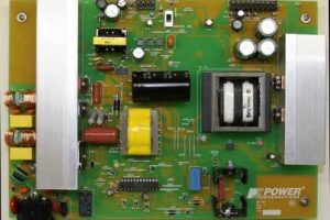

225 W (286 W Peak) Power Factor Corrected LLC Power Supply
225-w-40-inch-lcd-tv-power-supply-using-plc810pg
HiperPLC (PLC810PG) Specification 90 VAC to 265 VAC Input 225 W (286 W Peak) Total Output Power
5 VSB at 0.5 Watt
5 V at 9.5 Watt
12 V at 48 Watt (60 W Peak)
24 V at 168 Watt (216 W Peak)
Application 40 Inch LCD TV
Summary and Features
• Frequency and Phase locked PFC and LLC for ripple cancellation in bulk capacitor for reduced ripple current reduced bulk capacitor and reduced EMI filter cost
• Integrated PFC and LLC controller
• Continuous mode PFC using small low-cost EE Sendust core and magnet wire
• Tight LLC duty cycle matching
• Tight LLC dead time control
• Brown out detection circuit
• >92% full load PFC efficiency at 90 VAC using conventional ultrafast rectifier
• >93% full load LLC efficiency
