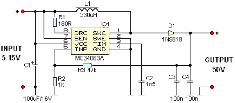

Sometimes you may get a small and simple changer on the 50th. Input voltage can range of about 5 to 15 without any significant change output voltage. The maximum current supplied is not large, it is only a unit mA.The changer is mainly designed for easy receivers,so that the maximum current is sufficient. Otherwise, I recommend to replace capacitors on the output transistor.Scheme is the involvement of the Figure 1 and is based on the recommended involvement of the circuit MC34063, which is the foundation.It was only omitted limiting resistor, which is not needed.
