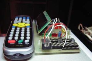

Gelelim ikinci devremize verici için Sony Televizyon kumandası kullanılmış alıcı devre ise pic16f84 geliştirme kartı üzerinde kurulmuş kodlama ise PIC C ile hazırlanmış
pic16f84_sony_ir
My remote control is a IMEX IM-1010 TV set on the code 199. There is a scheme that should be seen only feed the sensor “IR” and connect its output to port RA0 the CIP. (Nb. with some sensors necessary to insert a resistance pullup from 10 k sull’out) The code is represented with 12-bit to be received as follows
