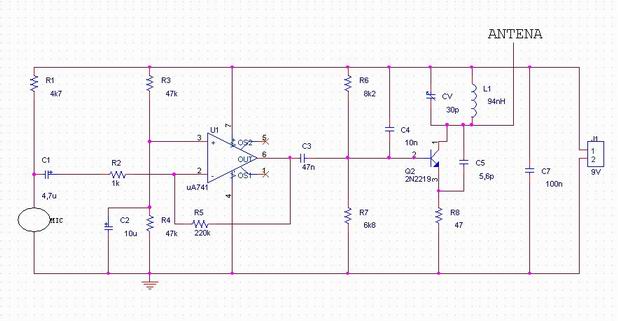

Our project is the construction of an FM transmitter for the range of commercial radio frequencies between 88 MHz and 108 MHz The transmitter is easy to build, has reduced dimensions and all components that are easily can be found in stores of venda of electrical components in storage or in your school. This provides a high power transmitter mainly in open areas and with its huge sensitivity is able to capture the minimum sound, and could even be used to carry out espionage.
1km_fm_verici
9 Volts (opcional 12 V)
88 a 108 MHz
500-1 km (antena)
50 mA a 100 mA (Tipicamente)
200 mW (Tipicamente)
Kaynak: FM Transmitter

    ben bu devreye benzer bi devreyi hazır olarak almıştım. fakat sadece çıkış tronsistörleri 2 taneydi. elemanlar felan hepsi aynı. ama 100mt fazla mesafede yayın yapamadı.:) ama belkide anten kotü olabilir yapacaklara tavsiyem devrenin şasesini toprak hattına veya toprakla temas ettirirlerse verim çok artar.
