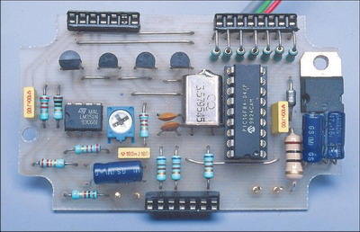

Hızsız alarm devresinde 16f84a mikro denetleyici kullanılmış projeye ait kaynak kodlari şema ve pcb dosyaları var.
It’s also just as easy to drive as before. As shown, the front panel carries a 3-digit LED display, a LED indicator and three pushbutton switches. Two of these pushbuttons let you set the alarm speed in 5km increments between 0km/h and 155km/h (one switch increases the speed; the other reduces it). As soon as you exceed the preset speed, the indicator LED lights and an internal piezo alarm briefly sounds at 10-second intervals to provide a warning
oto_display_hiz_alarm
Kaynak: http://www.siliconchip.com.au/cms/A_103208/article.html Alternatif link: pic16f84a-display-gostergeli-elektronik-oto-hiz-alarm-devresi.RAR alternatif link2
